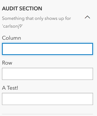

For your first question, yes, that's easy enough. You can use the function GetUser, then check the username.
var the_user = GetUser($layer)['username']
return the_user == 'carlsonj9'
Having an expression like this in the conditional visibility setting of the form group will get it to behave as you describe.
