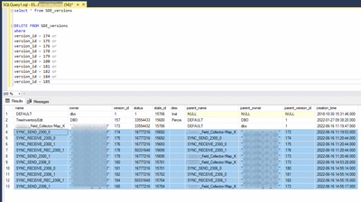

So the only solution we could identify was to access the SDE_VERSIONS table in the back-end DB and manually delete the dependent children of the main offline edit version. So in the screens below version_id = 173 is the main offline edit version that is visible in ArcGIS Pro and which cannot be deleted in Pro. The additional SYNC versions below that are all children of that version and these are not visible in ArcGIS Pro.  These versions should be deleted when the Offline Area is removed, but for some reason in my workflow that is not always happening.
So. I manually, and carefully, write out the DELETE statement for each of the child versions, double checking that it is part of the version tree of version_id = 173. Extreme caution here since this example on our dev environment is relatively easy and there are no other versions happening at the same time. In production, it is more likely that there are other versions mixed in among these, so it is an arduous task. Obviously be careful here because DEFAULT is right there! 😬 So we felt there was no "smart" SQL statement way to perform this, no range or JOIN, and that each WHERE should be typed out manually and deliberately.
With the versions deleted the, there are no more dependent children of the main offline edit version and that version can and should be removed in ArcGIS Pro only, don't delete it from the DB back-end!
