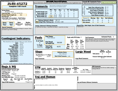

Hi,
How can I create a pdf report on survey records similar to survey123?
In the survey123 website, you are able to create a word document template with keyword config and page formatting that allows the attribute table and attachments to be positioned and formatted on a record by record basis.  (Attached Pic is of the Survey123 UI)
I want to do the same using non-survey123 data.  Specifically, field map collected inspection using identical feature class with attachments structure.

Hi, a potential solution is to create a layout file in ArcGIS Pro then publishing it as a tool. You may then link the tool in the Print widget in a WebApp Builder. See this video at the 19"30' mark.
DougBrowning
MVP Esteemed Contributor
We use Data Driven Pages in Pro, connect it to the service, run it nightly in a script, these are posted to sharepoint.  The design time in Pro can be painful but you can create complicated layouts.
Other projects I used ReportLab in Python.
But my first try is to show the users maps, dashboards, etc for a more modern approach.  Paper is such a crutch for users still but I have found if you create a all new tech system but keep the old workflow it never improves much.  Good luck

So your example is created in Layout not Report in ArcGIS Pro.... I feel like I'd have more success in Layout that Report.....  The small play I had with Report sent me cross eyed.
DougBrowning
Yes this is all in layout.  It for sure takes a lot of time but it did come out looking nice.
