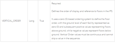

One last question. The first floor displayed on the picker: is it based on alphabetical order? In the case of the screenshots below, 'L1' is lower level 1. This is the first thing I see when I hover over this site. I would rather see '1' for the first floor. Should I change it to "F1" so it's ahead of "L1?"
Andrew-Bowne
VERTICAL_ORDER determines the order in which floors are displayed in the floor picker.
