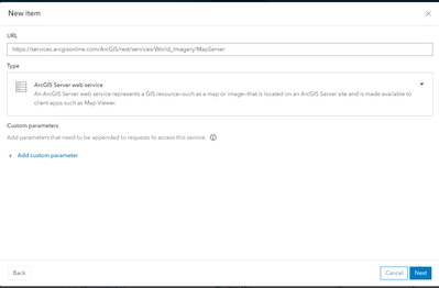

RachelS
Thank you @ColinLawrence  and @Eugene_Adkins
Unfortunately I'm having the same problem as the last poster on the thread you linked Eugene.
It's doesn't prompt for credentials with the World Imagery layer.
Not sure why it won't work with Imagery?
Eugene_Adkins
What version of Portal are you using? We're on 10.9.1 (older than 10.7.X may not function properly?), we use Field Maps (our field users sign-in via Portal with our organization's SAML), and we're able to take maps offline with the basemap you're referencing.
Using this URL for the tiled map capable of being taken offline: https://tiledbasemaps.arcgis.com/arcgis/rest/services/World_Imagery/MapServer (I believe this is the same basemap you have referenced but you can double-check) you should be able to add an item into your Portal (see the ESRI documentation here) as @ColinLawrence mentioned. This documentation will allow you choose the version of Portal you're using at the top.
RachelS
Hi @Eugene_Adkins
Your url seems to have done the trick and brings up the option to store credentials.
I'm using version 11.1 of Portal so not sure if that affected my url.
But it's all working as it should so thank you for your help.
