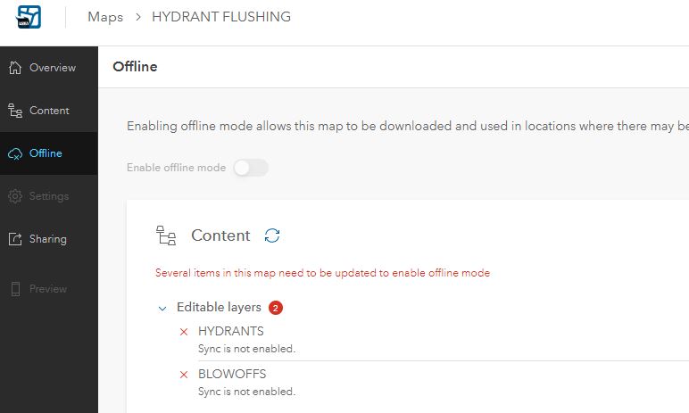

I upload a feature layer of hydrants with a maintenance table to Portal with editing enabled (geometry disabled so people can't move hydrants) to allow for creation of related records in Collector/Field Maps.  After uploading, in each web map I disable editing of the feature layer so that the blue + "add a feature" button is not in Collector/FM so that operators cannot add hydrants, but merely add related records. This work flow works using the normal map viewer to change these settings and configure pop-ups.
Whenever I open these in Map Viewer Beta, or in this case, Field Maps Beta web app to configure forms to make groups of inspections in the related table, after saving, it re-enables editing on my hydrant feature layer, adding the option on the mobile apps to add hydrants. This isn't an experience breaking bug for Map Viewer Beta, because I can open the map in the old map viewer, disable editing, then save there and it retains the changes. If I do this after coming from Field Maps Beta, it deletes the forms I've created.
There doesn't seem to be a way that I can utilize any sort of form grouping in Field Maps without opening the ability of people to add hydrants in the mobile app. I don't seem to have the ability to disable editing of the layers in Field Maps Beta...This is a pretty big limitation for us as I have had issues with users adding hydrants with the big shiny add button thinking they are creating an inspection. Help!

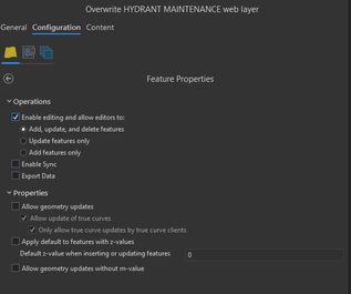

This is probably due to the fact that enabling editing occurs at the service level. The ad-hoc editing enable/disable setting in the JS 3.x map viewer probably just hasn't been implemented in the Beta stuff yet. It feels similar to editing a Map Viewer Beta popup in the standard viewer, then losing the settings you configured in the other viewer, because it's just not looking at the same settings.
All that said, I do believe that a solution will be coming in 10.9 (hopefully!). If you look at some of the editing settings in AGOL, where you can usually get an early taste of future updates, you'll see that on the editing settings, you can configure editing capabilities differently across layers.

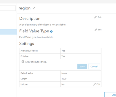

And then on the Data tab, you can individual fields as being editable or not.
It would be a bit of clicking (or a Python script), but you could configure the layer (or perhaps a view of the layer) to disable editing on all the fields and geometry of the hydrants layer and leave the related table open to edits.
Fingers crossed that this is coming in 10.9, rather than 10.9.1 or later.

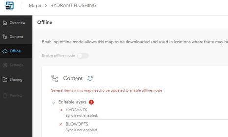

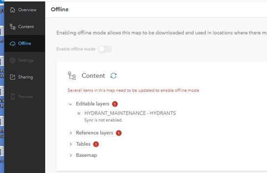

    Editing is not enabled (looking in the offline tab at "editable layers") until I create the forms and save the forms

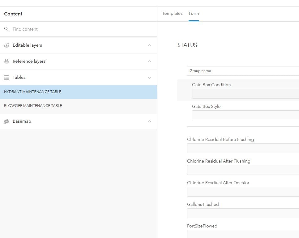

6. Open the table layer and convert the popup to a form
   Correct.
7. Save the map (Save the Form)
  After I save the form, in offline mode "editable layers" hydrants become editable.
8. Open the map in Collector/Field Maps mobile
They are editable if I open the map in classic web viewer, likewise, Collector/Field Maps gains add button. If I disable editing in classic web viewer and save the map, I lose the forms that were created in Field Maps.
