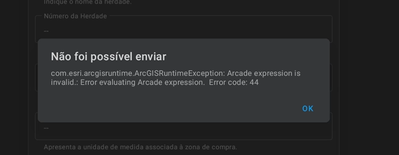

pnpferreira
Good afternoon,
We are in a roll out phase of the project for a client and this bug is having a big impact on the delivery time. Any predictions for a resolution? Can't you make the old (stable) version available in the respective stores until the situation is overcome?
