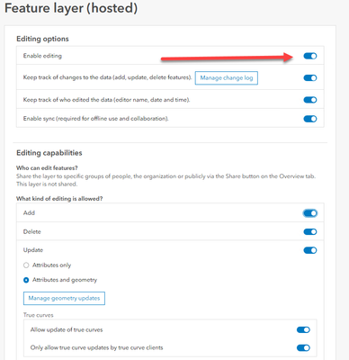

If you don't see the blue plus sign, first place I check is the editing capabilities in the Settings tab of the item details page:
R_
CassidyWheat
Editing is enabled on my feature layer. Any other ideas? Thank you!
