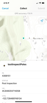

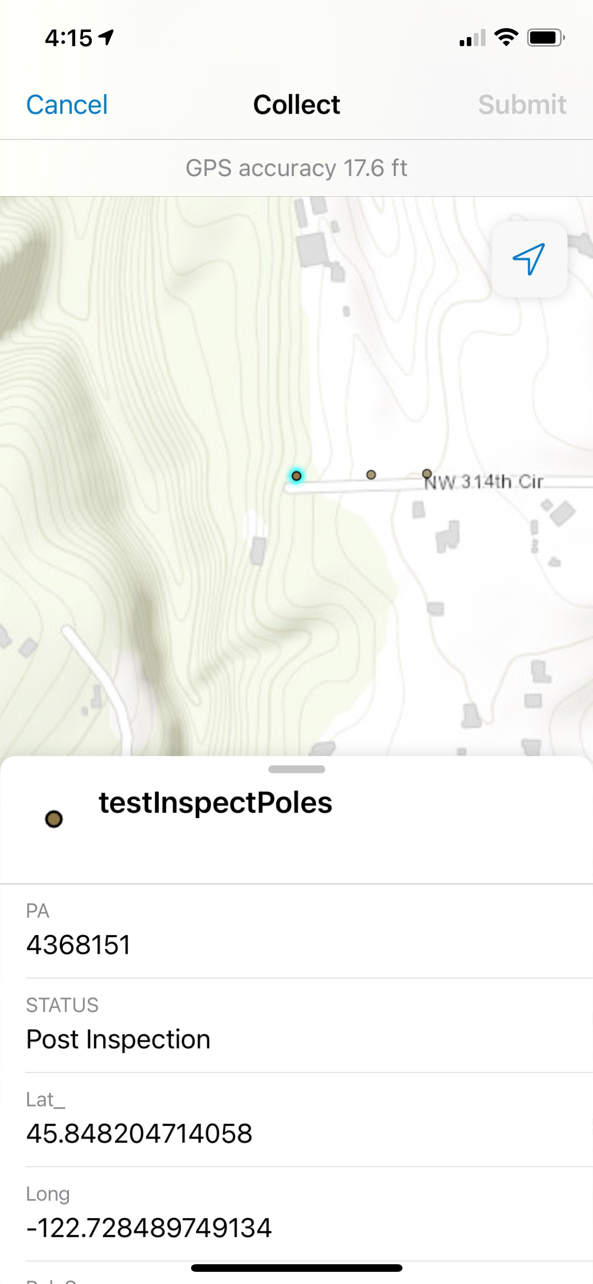

Is there a trick to being able to submit collected data in the Field Maps app on the mobile device? Data point is a hosted feature layer in AGOL, and is set to update only (data, not geometry). I can edit the data just fine in the web map (beta), but on my phone using the app, it won't let me submit (greyed out in the top right-hand corner).
I should mention that the fields that I'm trying to edit have domains associated, and they are part of a smart form. But again, no problems in the web map with editing.

@JoelPerkinsSee this thread: https://community.esri.com/t5/arcgis-field-maps-questions/created-smart-forms-for-layers-and-tables-...
Assuming you have the same issue, it should be fixed with our next update which is going live this week.

JoelPerkins
Looks like that's it. I changed the layer capabilities to include geometry edits and it let's me submit edits now. I'll wait until you push out the fix.
