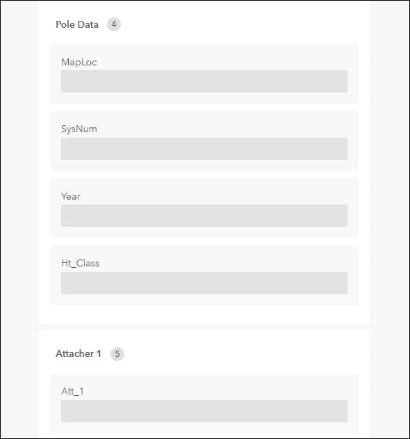

First I made a group for showing the pole data as shown:

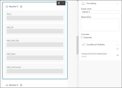

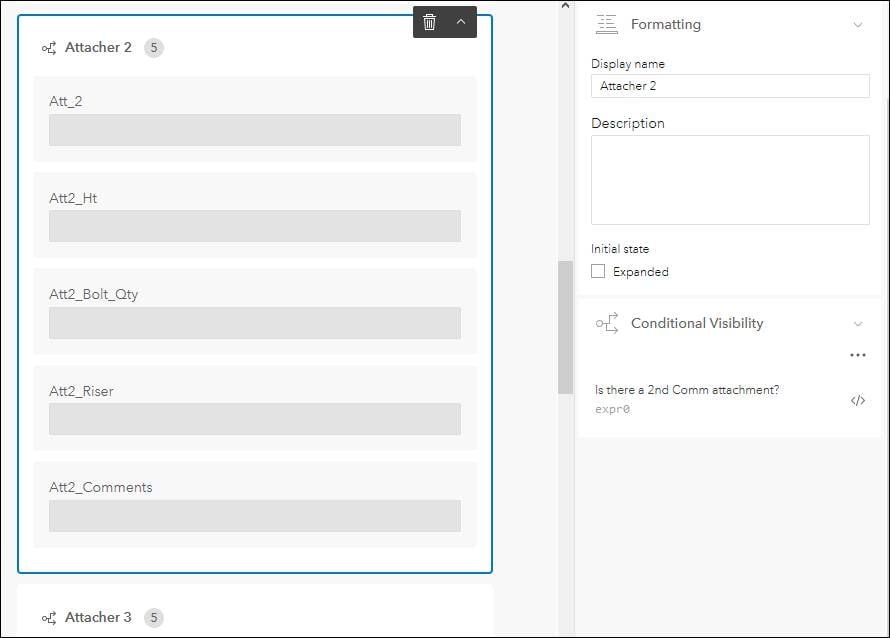

Then I have made a group for each potential communication attachment, anywhere from 0 to 4 attachments. I am trying to hide the groups if they are no attachments on the pole, or hide the Att_2 group if there is only one attachment, and hide Att_3 if there are only 2, and so on.

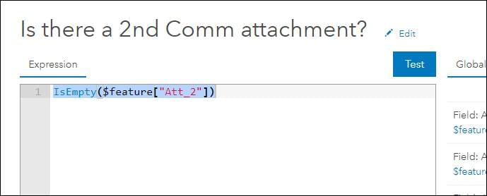

Here is my condition for Att_2:
So my first questions is which way the Boolean answer triggers hiding the Group. So if my Arcade expression evaluates to True, then does the Group show or hide? I’ve tried it both ways and neither one seems to work.

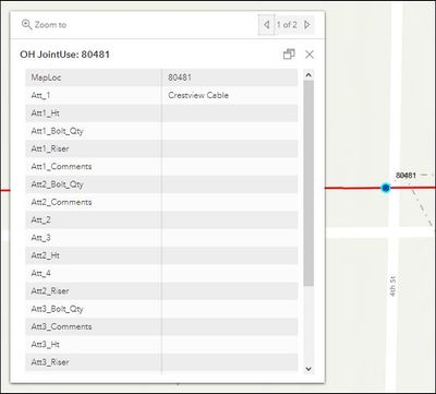

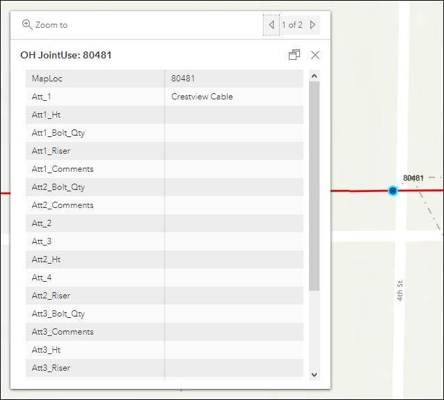

My second question is why the Groups don’t seem to work wither. The end users see a big long list of attributes just like they did in Collector.

the Group/Attribute show when the condition is True, so if in your case if this attribute is empty the the group appears.
Regarding the attribute - try this notation:  IsEmpty($feature.Att_2) - the attribute Att_2 on the feature.

Any comments on the Attributes showing up but not in Groups?

@BillHeigh  don´t know exactly how the Smart Forms will be implemented to AGOL.
As far as I´ve able to test it, it works with edit widget in BETA Map Viewer.
I am soryy, but I don´t know if smart forms settings will propagate to pop-up too - we will see on 30th March when it ´s going to go to live, but in current Beta I haven´t found a way. So, for now I would set-up pop-up manually.
