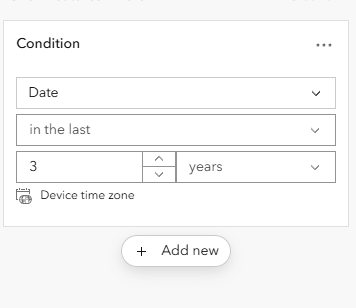

Bug description: Sync of an offline area fails when an editable layer includes any "in the last" time-based filter.

2. Create an offline-ready web map containing the layer as editable, and apply any "in the last" filter. E.g. "in the last 12 hours". Interestingly, you can apply this filter to any date field, not just the field named "date", and trigger the same bug. For example, a CreationDate field.

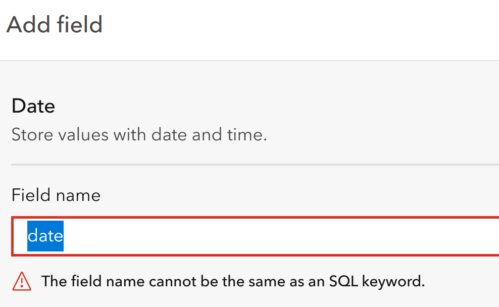

ArcGIS Online will not allow you to create a field called "date". Attempting to publish a layer with a field called date from ArcGIS Pro should probably trigger a warning.

Hi @suntoygeo , are you saying that the BUG you mention and link to has potentially resurfaced? I gave it a shot on some data using a relative date filter (i.e. "in the last") on a date field and sync is working for me.

Thats interesting. I set up this filter on a field "Date" and tried it on iOS and Android. I am wondering if there is potentially another variable. Are you adding/editing data that then falls outside or inside of this filter? It is good that the data does successfully sync at least.

I don't think the time period was the problem - I was using "in the last 12 hours".

I am now realizing Date was only the display name for this field in my data and the actual field name is "FDate" so I was not really replicating what you have. Date is a reserved SQL keyword so that could be the cause of the error. To clarify, after replacing the field with the updated name, are you able to use the relative date filter without error?

Correct, removing the field named "date" resolved the issue. Which I only thought to try after seeing the warning about reserved keywords on ArcGIS Online - I published the original service from ArcGIS Pro.
