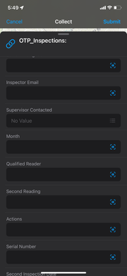

A similar issue happened to me. I made several edits to a form and the Save icon was grayed out. I eventually managed to save it but it converted almost all of my fields to barcodes somehow, removed some fields from the form and removed my calculated visibility.  I cant explain this and will likely need to recreate my form.
