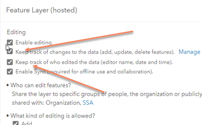

Enable creator/editor tracking on the feature layer and it does it automatically for you:

You could enable the editor tracking, then have a calculated field that sets your "name" attribute to $feature.Editor, which should also work in offline mode.
This way, the created/edited info is in there if needed, but, only the FM form with the calculated value would populate the "name" field.
