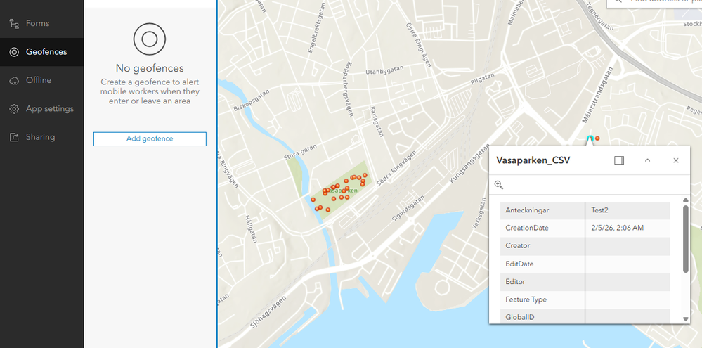

  1. If your device is low on RAM or storage, it can cause apps to crash, especially ones that require a lot of memory (like Field Maps).
  2. Try freeing up some storage space and closing other running apps to ensure enough resources are available.
  3. Android Jelly Bean API 16 is quite old, and newer versions of Field Maps may be optimized for more recent versions of Android.
  4. If possible, consider updating your Android operating system. While Android 16 may still work for some apps, the app may not be optimized for older versions anymore.

Thanks, but I'm still having issues:
I. I have 97 GB memory available, so it shouldn't be due to this. Plus, I was able to use the app 2 days ago.
II. All other apps are closed.
III/IV. I can't update my Android OS; it says it's up to date. My other device, a Pixel 8a, is running Android 16, too, and the app works fine there.
V. I was able to use Field Maps Designer to create a map with a brand-new layer. Unfortunately, FMD created some sort of hidden field or setting that didn't allow for the collection of data either on a browser or in the Field Maps app (on the working device). This is what started this whole issue. Since I wasn't able to collect data, I thought there might have been some setting persisting in the app, so I uninstalled/re-installed, and that's when it started crashing. I ended up deleting the map and layer, created a new layer in ArcPro and served it to ArcOnline, added it to a new map, and finally was able to collect data in both a browser and in the Field Maps app (on the working device).
