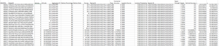

I have taken a snip from the output from the Catalyst which has been generated when I upload the data collected in Field Maps to ArcGIS online. Whilst I see the reported GPS accuracy in the top bar of Field Maps in the data file the values don't seem to be correct. ie they are metres instead of cm. I would be expecting less than 50 cm with the 30 cm subscription service that I was using and where I was conducting the survey. So I am not entirely sure what these accuracy columns refer to (image below and attached)?

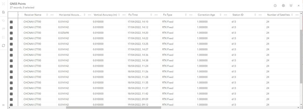

@EddieWBanks From the names of the fields, these do not look like standard Esri GNSS metadata fields. How did you get these fields? Standard Esri fields should look like below.
What is the value in "Fix Type" field for you? I want to know if the smartphone was receiving corrections via Catalyst or just using the internal autonomous GNSS. The accuracy values look more like the phone GNSS. That could also explain the shift from local control points.

Yes I just used the default settings that were provided. I see that if I go to the desktop version of Field Maps I can adjust some of these settings in the table. To me it is not clear though how Field Maps on the device is pulling the data from the Catalyst?
I have used both IOS and Android devices and the fix type seems to mostly 'fused'. However, sometimes you see that the vertical accuracy is better than the horizontal which shouldnt be the case. Also this was using the 10cm subscription service. I understand it takes some time to lock in but this is an area with plenty of 4G/5G phone coverage.
Whether this is because I have been setting the collection settings to 1 sec. Although the table shows that data is not collected at this frequency generally several seconds.

I just collected some new data last week and the downloaded data file from Field Maps shows vertical accuracies are greater than horizontal? WTF? So still not sure what and how Field Maps is capturing the data from the Catalyst.
In the top window of Field Maps while collecting data it reports the GPS accuracy, which seems to be that of the Catalyst subscription but looking at the data file it is very different.
I also require that my gps positions are collected every second, which it allows me to do so in the setup menu but it only reports the data every 2-3 seconds in the data table????. I realise that the accuracy might not be as good whilst walking along but my other gps has no issue in sending high frequency data.
