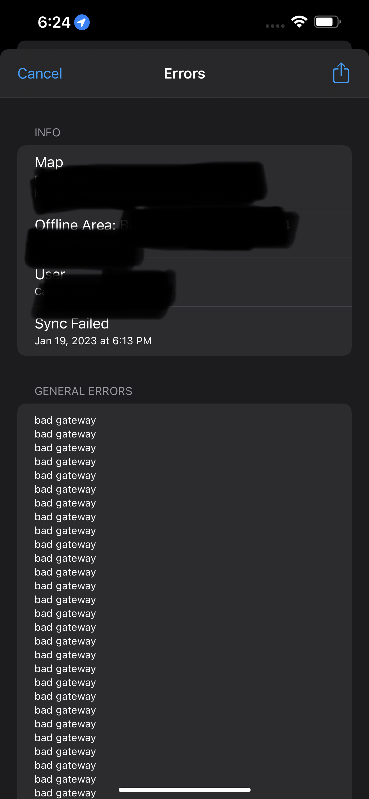

Trying to sync offline maps and receiving the following error:
It’s occurring for two maps that share some of the same area. I believe the number of bad gateways corresponds to the number of layers in the map

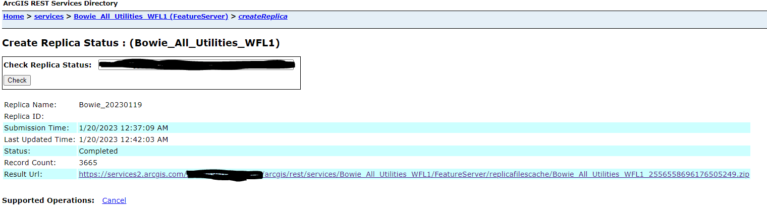

Tried to pull the data down from AGOL by creating a replica.
When I click on the link to download, I receive the message:

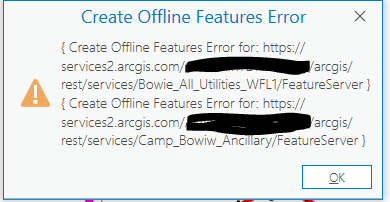

Update - 4:
Attempted to download the mobile GBD through ArcPro. I get a the following error.

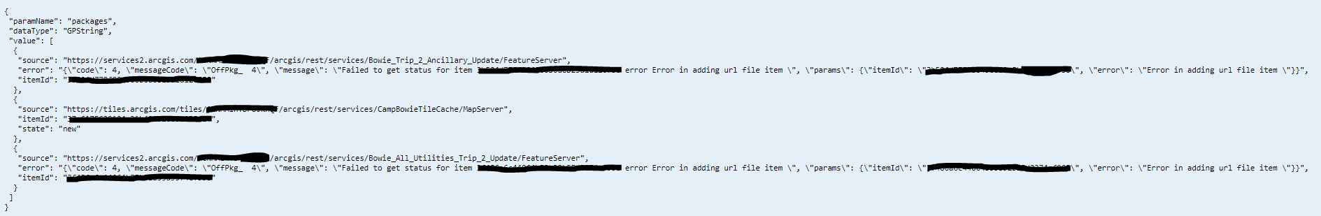

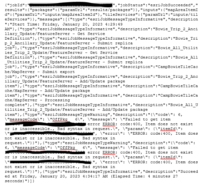

Update - 5
Receiving the following error in the network monitoring tool when attempting to create new map ares.
The json report is showing.
Update - 6
The issue appears to be widespread for hosted feature layers in my AGOL account. So far any offline areas for maps containing hosted feature layers is failing to create. Even maps with data that worked previously without issue months ago that have not been touched are failing to create offline areas with the errors above being the same as Update 5.
