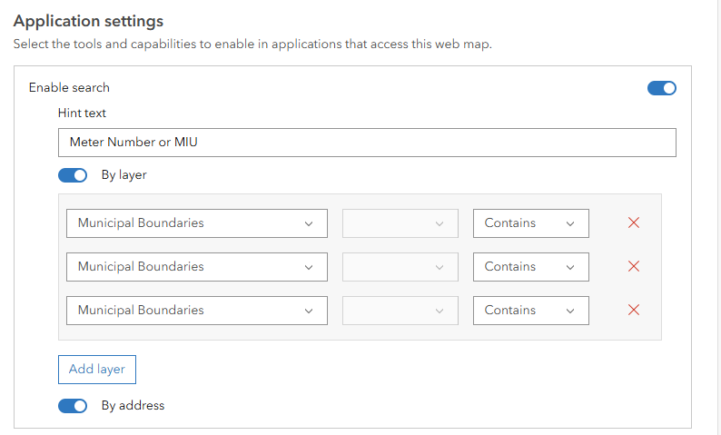

Hello,
Our water folks are using field maps to update water meter numbers and locations. I set this up about two years ago and it has been a stellar easy to use app. The original setup in the web map under Settings-->Application settings--> Enable search--> By Layer in which I could chose our secured editable water meter layer to search using several fields.
Today I noticed that our secured editable feature service is no longer a choice even though that layer resides in the map. The other layers do show but I don't use those for search. It somehow defaulted to Municipal Boundary layer for my three fields I originally set up for water meter attributes.
Maybe it's our older architecture? We publish on an old GIS server using Pro 2.9 with our database at 10.7.1.
Any ideas what would have caused this or how to fix it?

We've been facing this issue for some time. I put in a support ticket and was attached to several existing bugs and several new ones were created. Some defects are very specific and appear to be tied to configuration or environment. For us we just get what you are seeing - the same layer several times with greyed out options. Refreshing the page can sometimes get it to load correctly (though sometimes it'll drop layers).
It doesn't work reliably at all. We just refresh the page until it looks ok and then hope for the best.
This is with ArcGIS Online and Hosted Feature layers. None of the aforementioned specific configuration or environment issues.

haha wow. So basically this is another version of the previous bugs found is what you're saying? Should we put in a support ticket as well? Thanks for your response!
