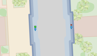

The expected outcome is that features that meet the expression and have been recently surveyed, as noted by a current "Last_Verified" date, will show a green check emoji   U+2705. whereas features that have not been surveyed (old date or no date) get a red X emoji  U+274C. This works great in Pro and in Portal Web Map Classic, as below in first screen.
Emoji labels working in Portal WebMapEmoji labels working in Portal WebMap

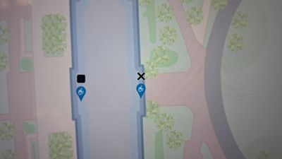

But in field maps the render is different. the colors are tied to the color of the label text configured in the Web Map Classic and the check box emoji only renders as a block.
Emoji labels not working in Field MapsEmoji labels not working in Field Maps

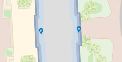

When using new Map Viewer, the emojis don't appear at all.
emoji labels absent in Portal new Map Vieweremoji labels absent in Portal new Map Viewer
