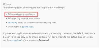

2) Published out map from pro where the layers are defined under a subtype group layer. This does not seem to be editable in field maps.

hi @maiam ,
Unfortunately I think the answer to your questions is within the limitations list in this documentation page: https://doc.arcgis.com/en/field-maps/ios/use-maps/utility-network.htm#ESRI_SECTION1_D9E9DD1BAA784C79...
