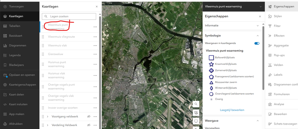

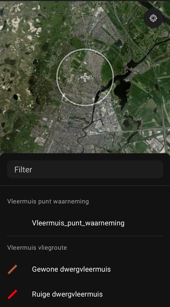

JurgenRotteveel
Hi Colin, I added a screenshot of the web map with the Symbology that does not show in Field maps in the picture below.
ColinLawrence
Sorry I may need a bit more clarification. I looked for this symbology in Map Viewer and I dont believe I can find it. Is these found under "vector symbols" or somewhere else? I see from your other screenshot that the symbol does not show when selecting a layer for editing. Do the symbols draw when features are created or for existing features? The map looks empty but im not sure if there are no features or they are not rendering. Thank you!

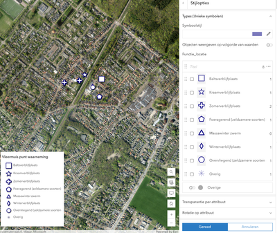

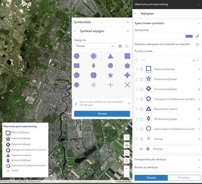

JurgenRotteveel
Hi Colin,
I found the symbols in the ''shape'' category in the Web map viewer:
They do Show up on the map but they dont show up in the list in Field maps when i want to collect data
