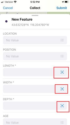

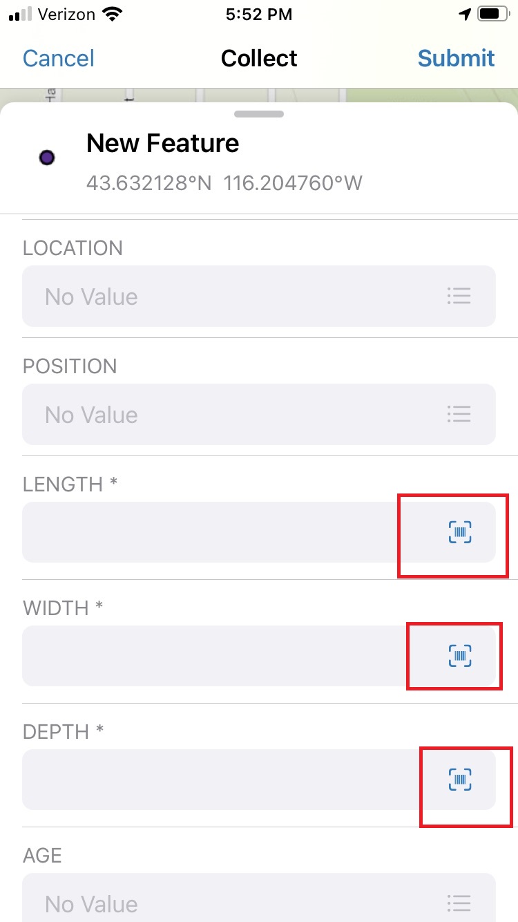

I received this geodatabase from a colleague for a field excursion, collecting data per the gdb domains, feature classes, etc.  It appears that EVERY field without a Domain defined is enabled for Barcode scanning functionality in Field Maps / Collector.  Does anybody know how to disable this?

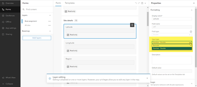

In the Field Map Designer, click on the field and change the Input type

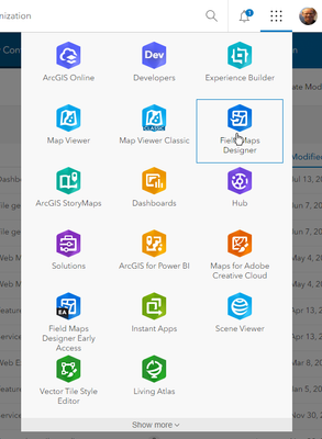

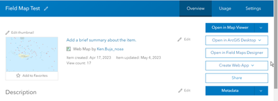

There are a couple of ways to get to the Field Maps Designer: through the app launcher, clicking in the item list, or on the maps's Overview page
