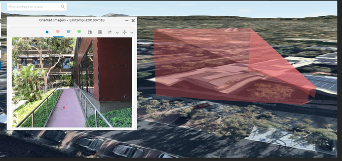

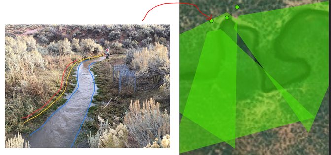

I did this using the oriented imagery toolboxes. They were a bit of a pain to setup since it is an exe that I add to get approved (just make it a zip) and it installs to the root of C (that is way out of style).  You have to run the tools then it creates viewshed cones features.  Then you have to publish this as a layer.  So of course it is always out of date.
  https://doc.arcgis.com/en/imagery/workflows/resources/managing-and-visualizing-oriented-imagery.htm
https://www.arcgis.com/home/item.html?id=36ee0bbedca64a5a8b68d7c69ab51728
If there is another way I would love to hear it.  I would be nice to be dynamic vs running tools and creating layers all the time.  But this is the way a lot of things are.
