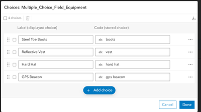

One thing I would check is that the default value you are using matches the code of your multiple choice element. For example: If I wanted a default value of Steel Toes Boots and Safety Vest to be reflected in this multiple choice element (see screenshot below), I would set the default value to "boots,vest". Note that you need the comma delimiter (without a space), to match the case sensitivity, and to match the code not the label.
