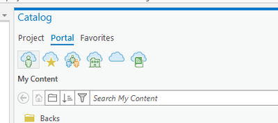

For editing, I just load the hosted feature layer into Pro through the Catalog/Portal connection.  Then I am editing the same dataset that Field Maps uses (with Pro), and updates/changes are real time.
