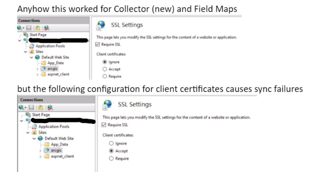

Solution Identified:
It turns out that the hardened down IIS configuration was responsible. In IIS 10 / MS Server 2019 hosting ArcServer, all websites were configured with SSL (Always) and Certificates (Accept) to provide two factor authentication for all access, but still allow applications to "tunnel" if a certificate is not provided. This worked for Collector Classic, but prevented the subsequent sync operation in Collector (NEW) and Field Maps. Keeping SSL (ON) , but changing Certificates to (ignore) resolved the issue for Collector (NEW) and Field Maps.
