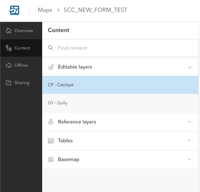

ShaunGibbins
Hi Kerri
Dhowal was posting on our behalf so it's my problem he is trying to find a solution for.
If I change my inspection table to a point feature class and block manual location then this would indeed provide a solution to the dilemma.
Is this setting available in enterprise and if so what version as I am not seeing the option in our 10.8.1 environment.
