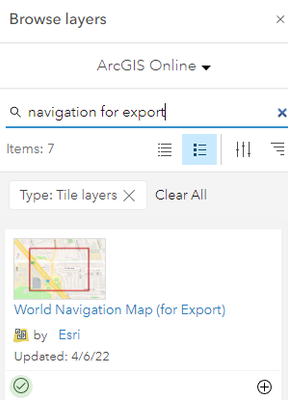

MarkBockenhauer
This can work... for example I made a map with Esri imagery as a basemap.   I then added an operational layer which is the Esri Navigation basemap service.
When I create a pre-planned map or take it offline on demand in field maps, the Navigation Map (vector tile) is an operational layer that I can toggle on and off, to see Imagery basemap.
