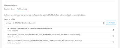

"Configuring the Search widget with a layer source from a map in ArcGIS Experience Builder creates field indexes with '-' in the name that will cause SQLite replicas to fail for the feature layer."
To check if this is the problem, you can look at the layers settings page in Online and in the Manage Indexes section view the Field Indexes.  If you see an index name with a hyphen ('-'), this might be the issue you are seeing.

Yes, I am seeing three different fields with hyphens. How would I remedy this situation? Would I just need to remove the search widget and the associated indexes?
ClayDonaldsonSWCA
I can confirm that removing these indices with "-" has resolved the issue on our layers. Thanks for sharing, this mystery was driving me crazy.

I was going crazy with my maps that were working just fine. The same error as OP and I found one layer with the "-" on the index name, created by Experience Builder widget. After removing the layer from the map, the map started to work just fine as before.

I have also been experiencing this problem. I deleted and re-created the broken indexes and it resolved the issue, however it seemed to popup again this morning and I had to repeat the process.

From the settings page, you should be able to delete those indexes from the layer and recreate them with a different name, without any hyphens

I have also run into this issue, but two of the indexes are locked involving creator and editor fields. I removed the Experience but these indexes remain locked. Besides removing the layer, is there a way to remove these indexes? Any help would be appreciated...
JustinColville
@FRODF you should not need to remove all of the indexes.  It is the indexes created by Experience Builder that have a hyphen ('-') in the name that is causing the issue.  Taking a map offline should work with the other indexes present.
