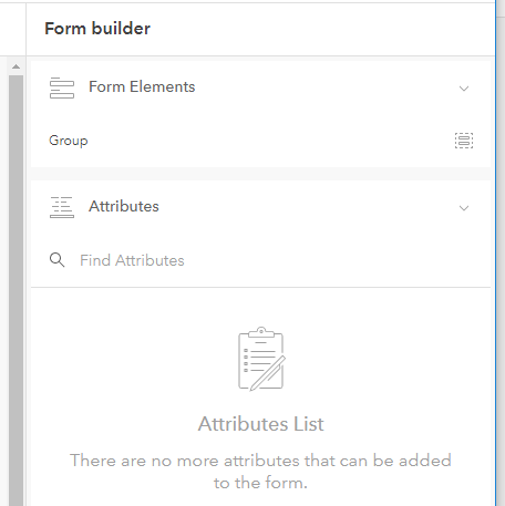

Is there way to add text to my form also?  The only option I see is to add Attributes.

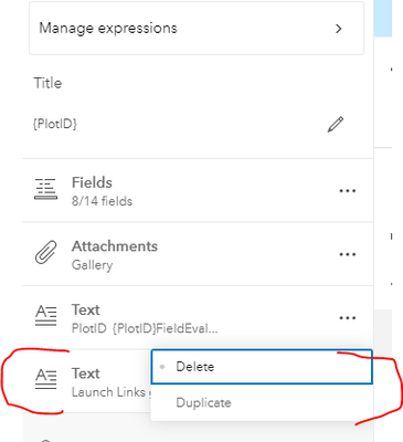

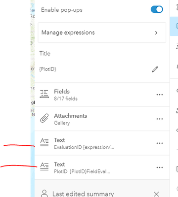

In Map Viewer Beta you can add multiple Text boxes.  I would be cool to be able to Hide/Show those in my popup or form.  But only options are Delete or Duplicate.  But I am also seeing that Field Maps will only show the first Text box section of a popup.  The web map shows both but Field Maps only shows the first one.
So I thought I could use the Conditional display in Field Maps but again I see no way to just add text.  Any have any ideas on how to do this or if it is coming?

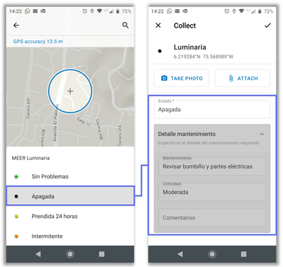

It is not entirely clear to me why you want to add text to the form. Does this include an explanation about what needs to be done? Field Maps can show custom HTML in the pop-up (as far as I know). You can use divs to group information and use an expression to define the visibility in HTML.

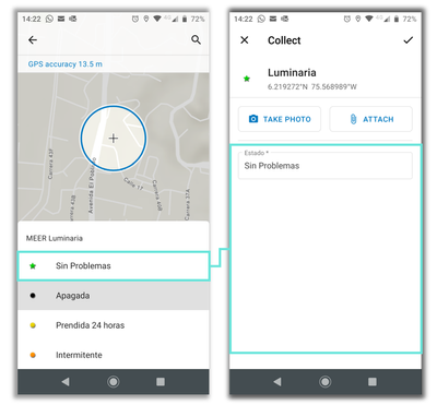

To show certain fields depending on the situation is something that can be done with Field Maps. You can create a group and apply conditional visualization on a group of fields or on the field level:

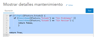

See below the simple expression used in this case to hide fields that requires the user to specify the problem in case no problem was detected in the field.
And this is how ArcGIS Field Maps will present the form depending on the situation. Specify the details:
... or not...

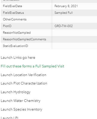

Here is an image.  In the new Map Viewer beta you can have multiple text areas in your pop up vs just 1.  Not a form but the pop up.
So the idea I have is to have 2 text areas and pick which one I want to show based on the feature type.  Say if it is a Visit I show text box 1 and if it is a revisit I show text box 2.  Or a crew vs a manger lets say.  Would be way easier than having 2 maps.
Does that make more sense?  AGOL team said they are adding this at some point.  The issue seems to be that Field Maps is not showing the second text box, just the first.
