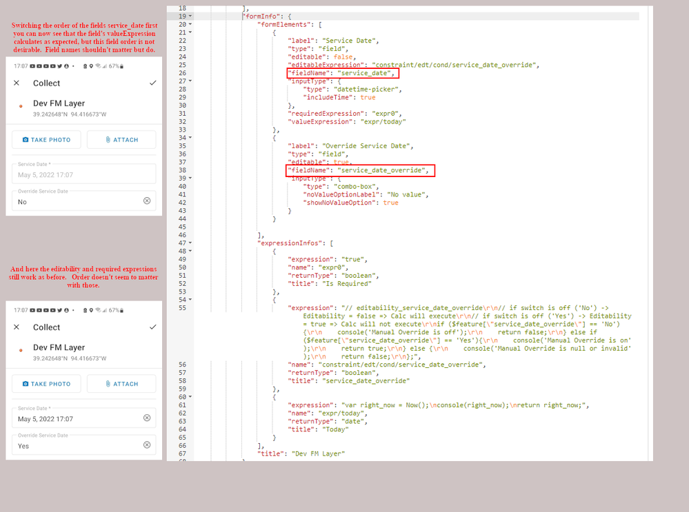

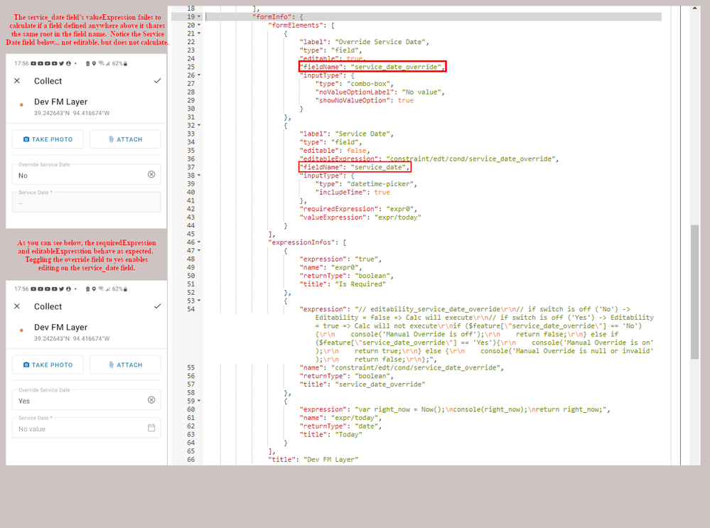

Say I have a field named "service_date" that has a form calculation and another field called "service_date_override".  These field names have a common root... "service_date".  Another example is a field named "stationing" (a calculated value) and another field named "stationing_offset" which have a common root name of "stationing".  On Android if service_date appears after service_date_override in the form order, the valueExpression does not execute.  In fact all calculations below seem to not calculate.  Below you will see some examples of what is happening.
The order of fields as intended.  The valueExpression for the service_date field never fires (no animation either).
Original Field OrderOriginal Field Order
Switching the field order in the form, the valueExpression for the service_date field fires as expected, albeit not in the order I want or that is logical for the user given that I have an override switch control editability of the service_date field.

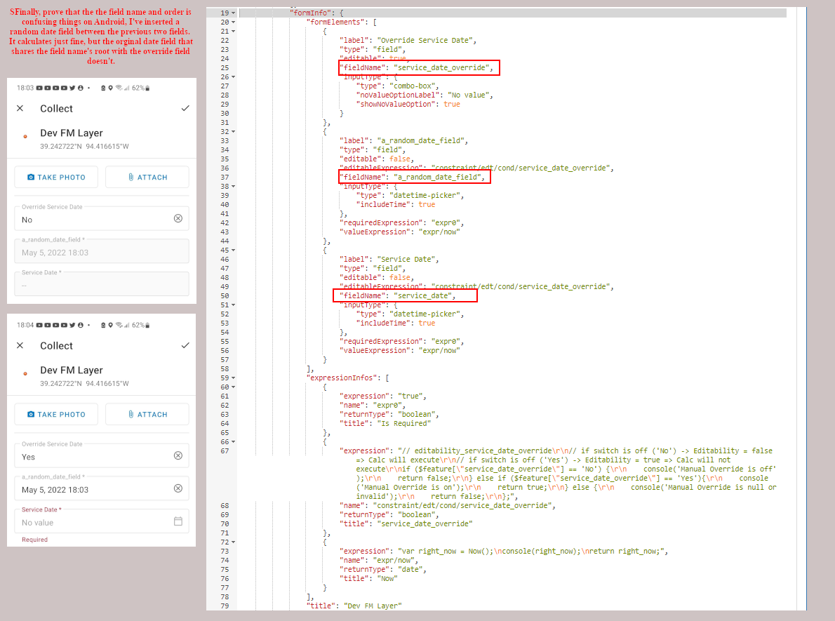

Finally, to confirm that this is the issue I added another date field between the to fields that have a common field name root that had a different name all together.  The valueExpression for the new field fires as expected, but again the service_date field does not calculate.
