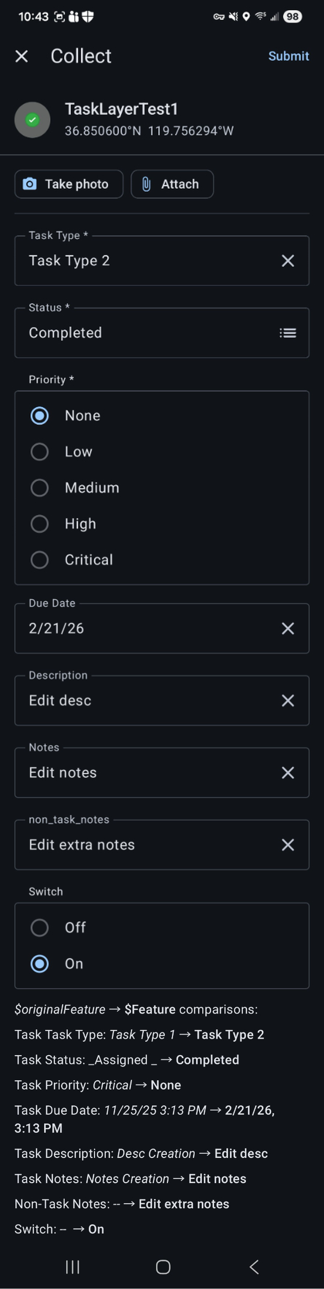

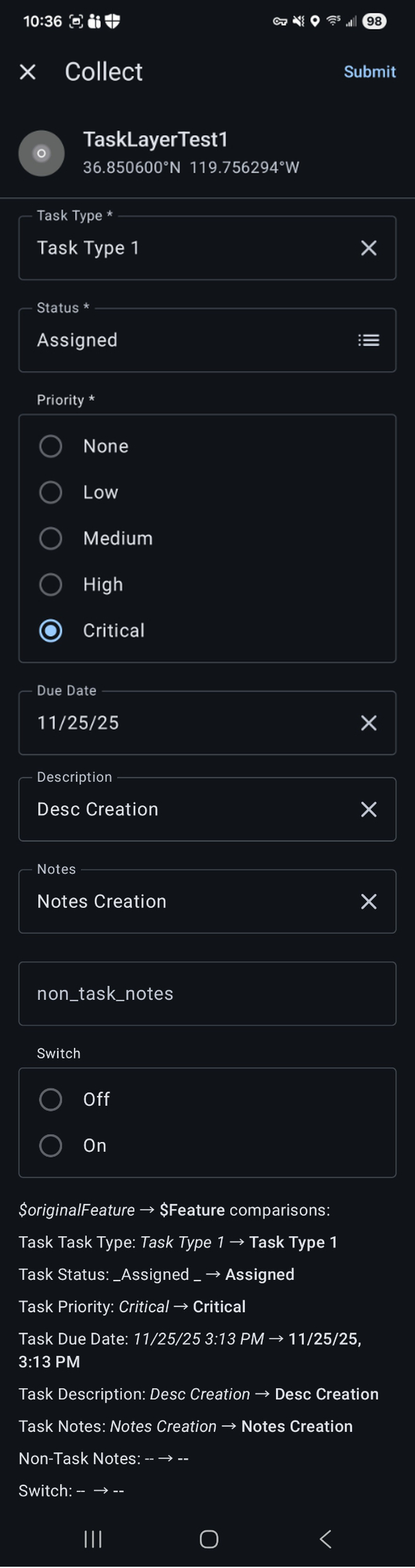

     However, it appears that when accessing the "Edit Form" from the Task list and menu (meaning that "Edit Form was added to the Task layouts as a Task Action) ... it frequently resets the fields back to the pre-edited values during editing. It's not always consistent WHEN it decides to reset everything (as in time elapsed or number of "aparrant" edits), but it is consistent in that it eventually WILL reset after enough edits. I suspect it is after a certain amount of edits, including background calculations and re-calculations made, as it seems to happen sooner with more editable form fields and calculated expressions running.
     It is most easily noticeable by adding a simple Info field into the form that displays the current values of the fields of the feature, and then editing one of the fields several times. Sometimes it takes editing a field over 70 times, sometimes I can't even make it all the way through a form without it resetting mid-way.

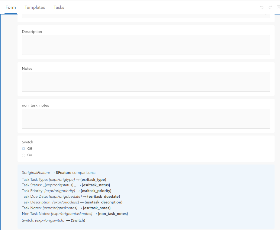

How the Info form element looks. Note: the "Expr/orig..." Expressions are just simple things like
return DomainName($originalFeature,"esritask_status")

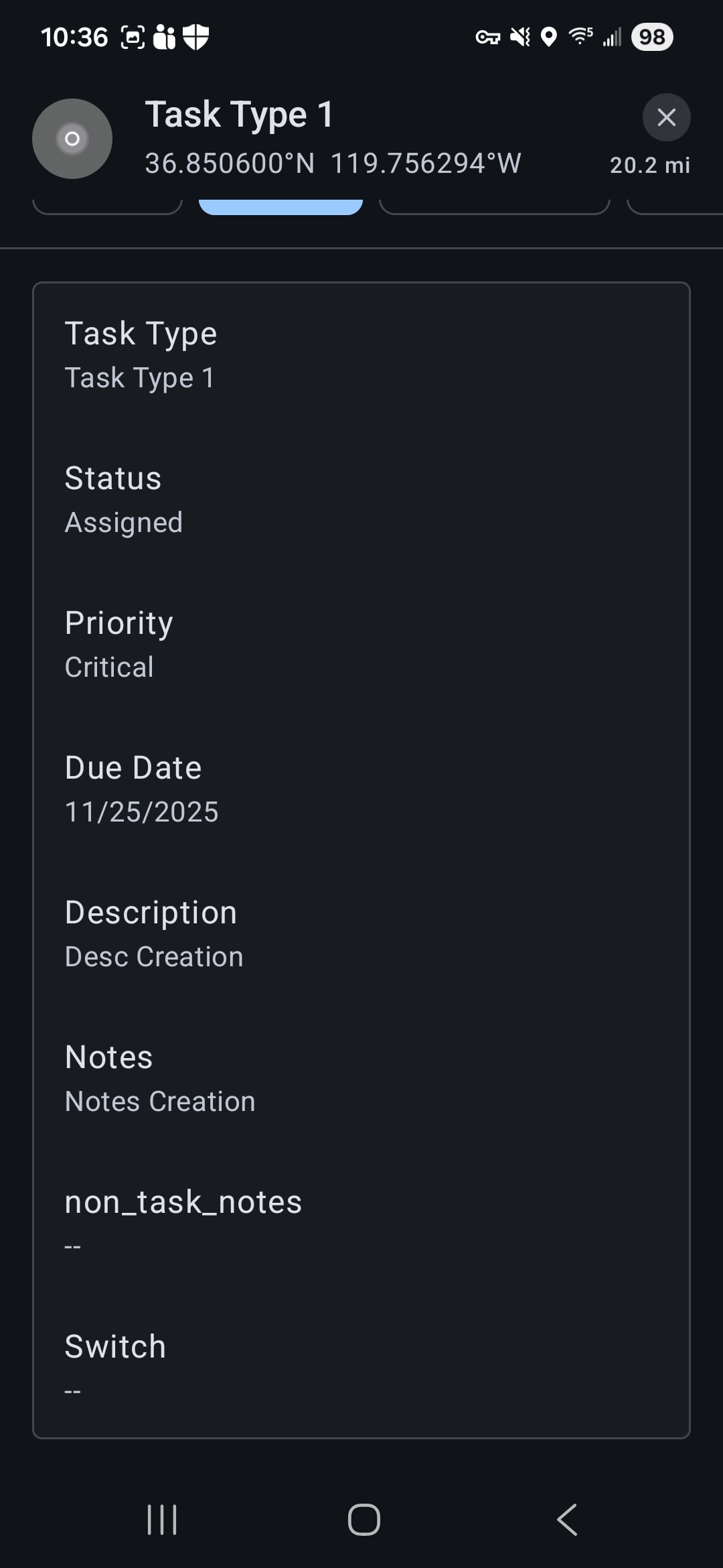

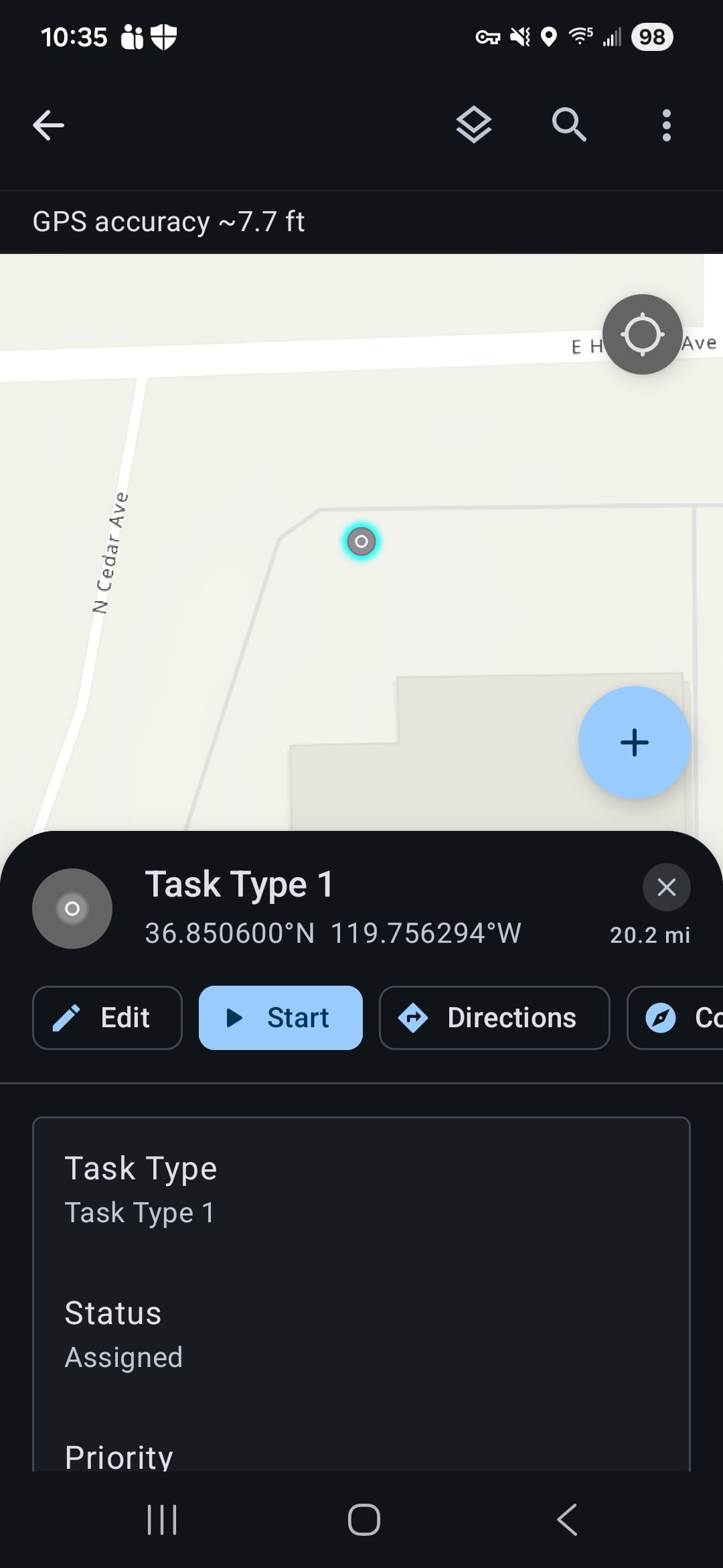

Initial Pre-Edited from Field Maps Mobile Popup View:
Initial, Pre-Edited values and display in the Form when choosing "Edit" from the Task options:

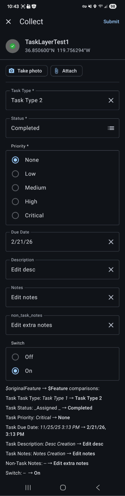

Edited values, before the feature decided to reset (I actually needed to re-do this a couple of times because it kept resetting the feature mid-edit most times):

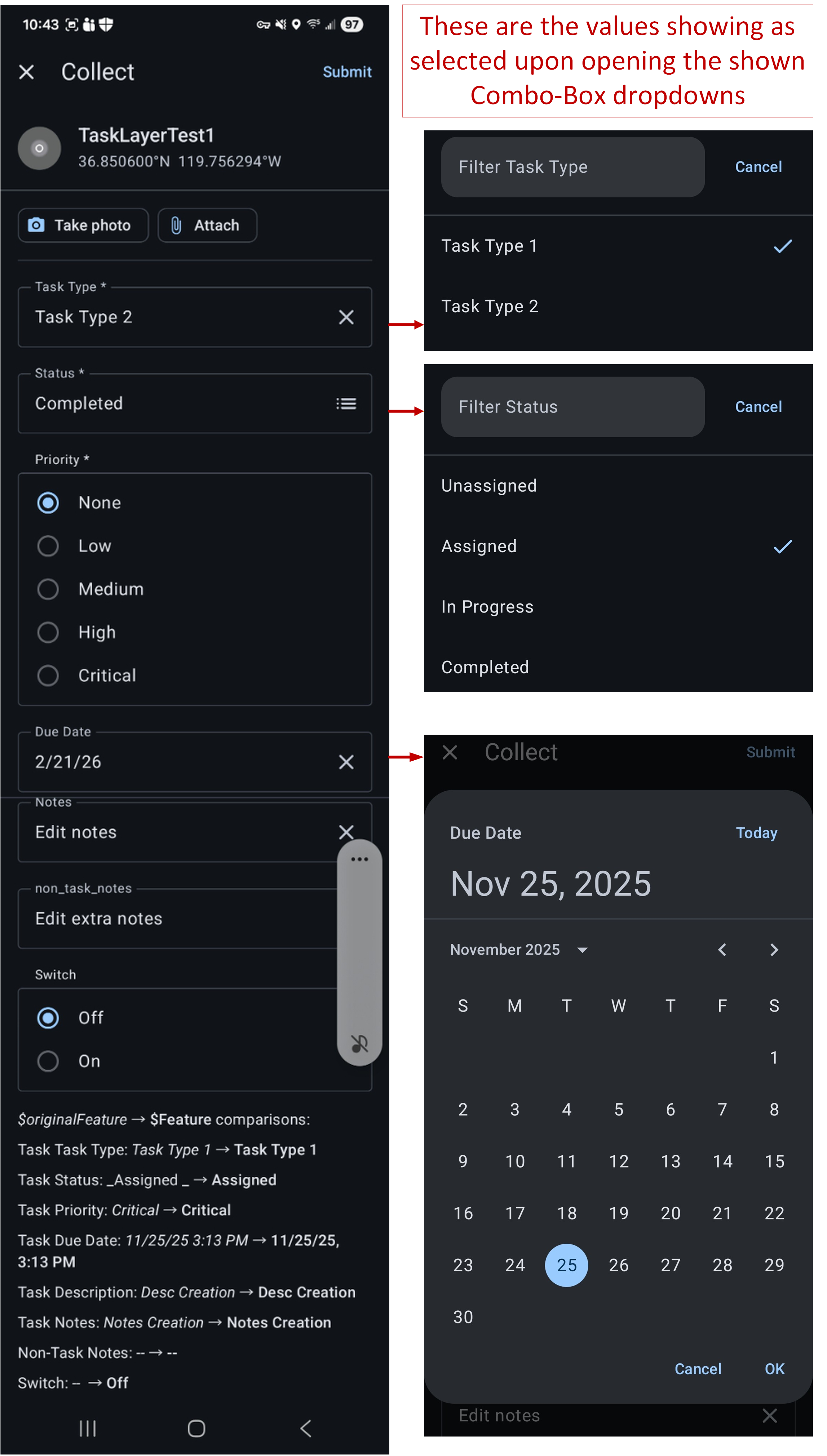

     Then, after re-editing one of the fields, such as toggling the Switch on the bottom one or two times (or any other field), it resets the entire feature back to all of the $originalFeature values, but keeps the selected new values cached in the Combo Box and form field DISPLAYS (not values, as seen below when opening them):

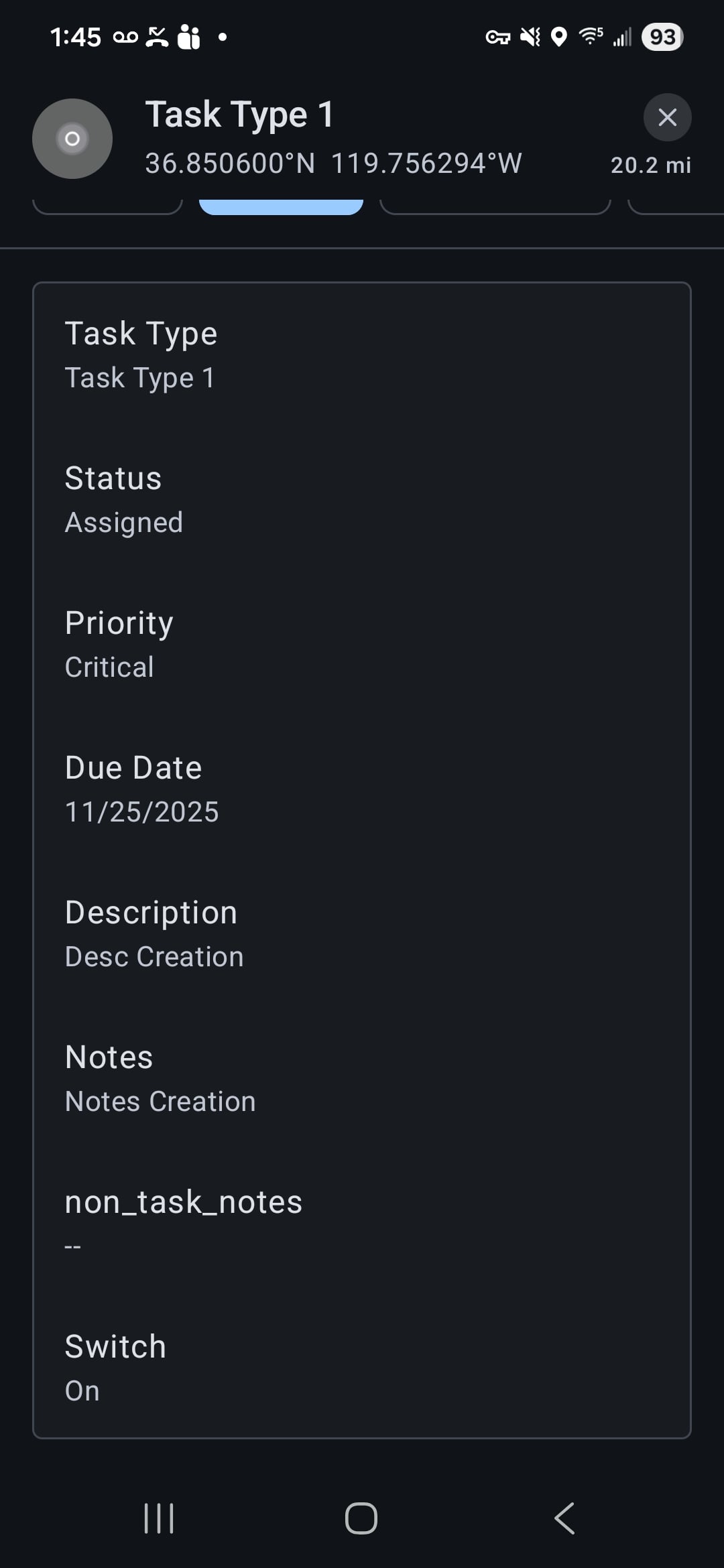

   If I then hit the "Submit" button... It submitted just that last edited field that changed after everything reset, confirming the Info display element is accurate in what the current values are:

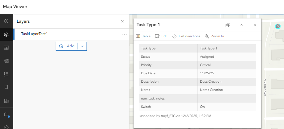

And the view of the edited feature from the Online Map viewer, confirming: 
(Note that during the edit, I had also moved point feature into the middle of the ocean to see if the geometry reset as well, which in fact it did)
