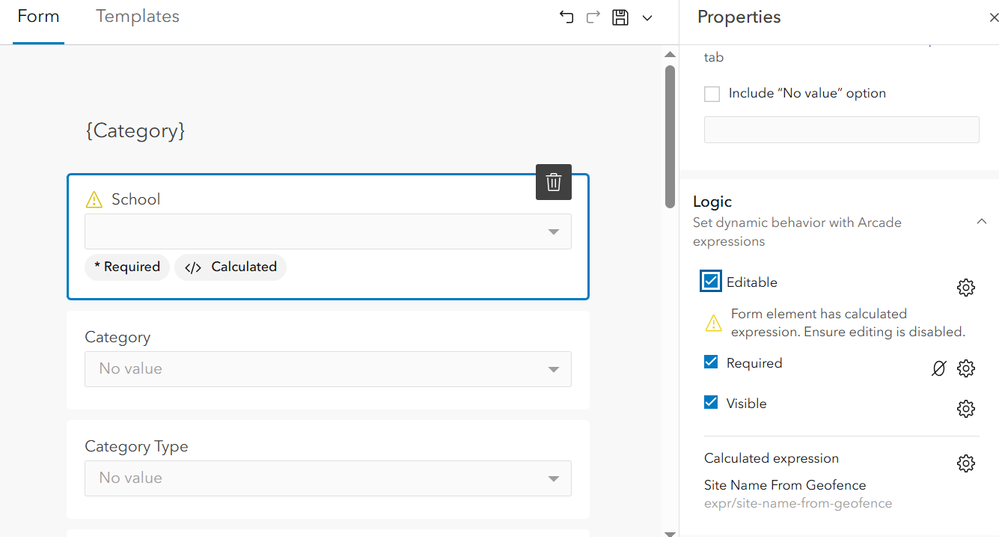

LeviCecil
Hi Chris, I've revisited this and it's working. The problem I'm running into is that I want the field to still be editable if someone is making a report and they aren't in the site's geofence in Field Maps. Is there a way to make it calculated, but also editable?
Here is my expression
var geofence = FeatureSetByName($map, "Security_Geofences",['Site'])
var site = First(Intersects($feature, geofence))
if (!IsEmpty(site)) {
    return site['Site']
} else {
    return null
