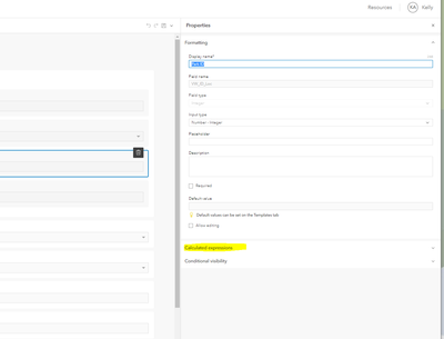

ArmstKP
Yes, that is possible by using Arcade and a Calculated Expression for the address field.
SPGilbert
Can you please elaborate @ArmstKP . I understand we can use arcade expressions to pull from other data layers within map but still do see how to auto populate attributes directly from "dropped pin"/"collect here" screen.
ArmstKP
@SPGilbert I guess I don't understand.  You can create a calculated expression, that goes out and finds the address number that intersects with the dropped pin/point and it populates that value in this field in Field Maps designer...
