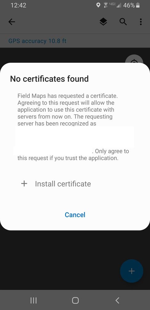

Hi,
I am getting this issue at random times on Field Maps Mobile for ArcGIS Online.  It doesn't  happen to everyone but some people (2) are getting this on Android.  The services used in Field Maps aren't using sync in anyway, I am not sure how to fix this.

  • This was only impacting our Android devices; all other access to Enterprise is fine. Esri verified the health of the system, certs etc. Determined was IT issue.
  • Conferred with an Esri Partner that supports Esri client infrastructure & development and indicated several clients facing odd cert issues starting last night as well.
  • Within the Android device, only mobile apps faced this cert issue: 3rd party app, Field Maps, Collector. See attached error messages.

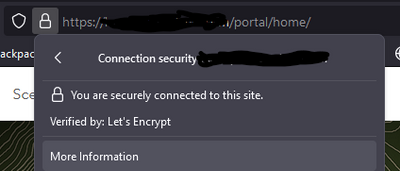

  • From desktop: navigate to your portal URL and view, cert info click on padlock icon next to the portal URL
    Click More Information

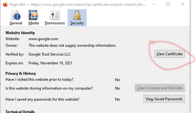

    View Certificate
  • Click the R3 tab and scroll down to 'Miscellaneous' and download PEM(cert)

  • Back on Android device: Settings>Biometrics & security > Other security settings> Credential Storage Install from phone storage> (on my device i select CA certificate, on other tablets it didn't have an option but import worked as expected; I didn't need to supply a name but they did and named it something appropriate)> maybe a warning > install the thing >reboot > open app and see if error clears.
This fixed Collector and Field Maps but so far not the 3rd party Esri app. I expect this may have far reaching impacts for Esri Partner devs.
