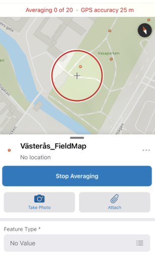

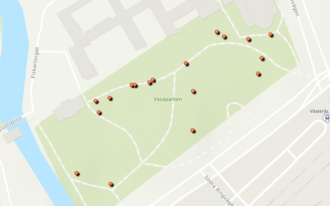

I created a simple data collection map using ArcGIS Field Maps Designer. Then, I went to Vasaparken in Västerås to collect information about the benches located around the park. When I began collecting data and taking photos, everything worked at first, but I had to stop and restart the Field Maps app for each location. It displayed the following message: Has anyone experienced this problem?
The offline photo capture and feature addition worked successfully.
Vasaparken FieldMaps

Have you tried setting the GPS to 30-point averaging? The issue actually occurs when the GPS fails to read. I created it using ArcGIS Field Maps Designer and haven’t tried creating it in ArcGIS Pro yet. Using ArcGIS Pro usually takes a bit more time.
