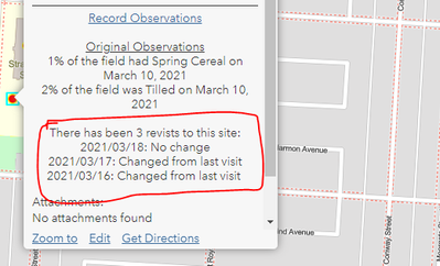

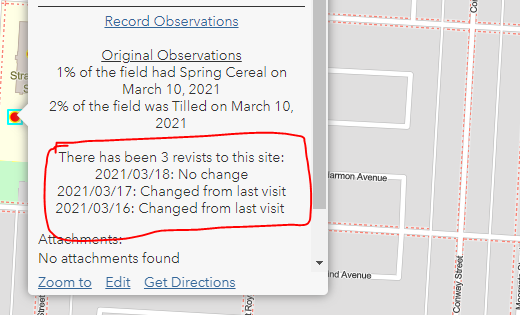

I have an Arcade pop-up expression that works perfectly in the traditional Map Viewer.
I would love for this pop-up to work in Collector or Explorer but they come up blank in both. The expressions above it work fine but they don't use IntersectLayer or FeatureSets.
Ideally, I would like to be forward thinking and have the expression work in the Beta Map Viewer and Field Maps but they don't work there either.
If anyone has any ideas please send them my way. At the end of the day, I want it to work on a mobile app experience (Collector, Explorer, Field Maps).
Here is the Arcade expression;
var intersectLayer =Intersects(FeatureSetByName($map,"Revisits"), $feature)

@mapmcburneyfrom a mobile perspective Arcade featuresets are not supported in Collector or Explorer.  They are, however supported in ArcGIS Field Maps.  Can you elaborate on the specifics of the layers you are querying against?
