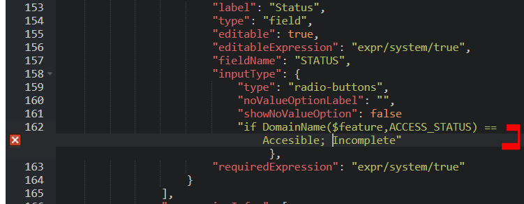

For an AGOL hosted feature layer, I've created a form for field workers to inspect catch basins for cleaning and functionality of the grate. The entire thing works great except I want the final question/status of the inspection, to default to “Incomplete” if the response to the first question in the form is anything other than "Accessible". To be clear, this isn't a question of it being visible upon the condition, more of an attribute rule/contingent value issue. I want it to default specifically to "Incomplete" value based on the first question response being anything other than "Accessible". Is it possible to make this happen by inserting an "IF" statement by editing the JSON for the web map in ArcGIS Assistant?  If so, what is the proper syntax within JSON?  If it’s possible, I suspect it would fit in somewhere as shown below? (Obviously this syntax is incorrect.)

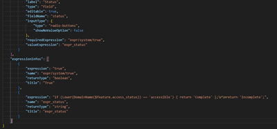

If you are truly wanting to do this in the JSON yourself. It would look like the following.
Your expressions don't belong with the fields, they belong in the ExpressionInfos section of the JSON.  Your fields reference them.

Thank you both so much for the quick reply.  Since I didn't feel I had enough time to recreate the entire form in Field Maps versus within the map I decided to go the edit JSON route.  The editing itself went fine but when I tested it in Field Maps the status field did not populate with either “Complete” or “Incomplete”, although I got no error.  Also, I realized while I was testing the change that multiple “if” statements are required to auto-populate additional fields based on other responses to ensure complete and accurate data.  Is this functionality more feasible within Field Maps, is there more control/options other than conditional appearance of a group, or am I describing a custom script to be written in JSON?
