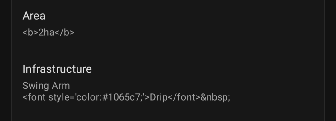

Hi all,
I've spent some time setting up a dynamic and nicely formatted arcade field elements list per: https://www.esri.com/arcgis-blog/products/arcgis-online/mapping/part-2-introducing-arcade-pop-up-con...
Unfortunately HTML appears to render as text within Field Maps.
  • Does anyone have experience with this situation?
  • Is this functionality planned for future releases?
  • I wonder if there is a way to test for profile type in Arcade so I could exclude HTML being returned within Field Maps
  • I wonder if anyone knows how to implement Field Highlight functionality from Pro into an Arcade field element. I haven't managed to find any documentation on that quite yet.
I think it's worth noting that Arcade appears to evaluate differently between Map Viewer and Field Maps as well. I'm getting errors in Field Maps that aren't an issue in Map Viewer - I'm yet to track down exactly which logic is different.

Hi @BlakeMorrison. Would you mind sharing your Arcade expression? You mentioned that the expression evaluated differently between Map Viewer and Field Maps, did the expression show any errors in Map Viewer or only in Field Maps? There are some profile differences between the two, so it's very possible to see different behaviors between the two applications.
