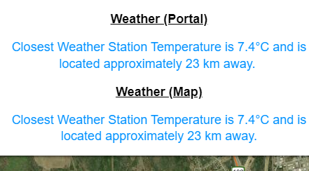

  • I tested adding the hosted feature layer to the map and comparing FeatureSetByName and FeatureSetByPortalID. The FeatureSetByName option works in Field Map. I've attached the same selected feature in AGOL map viewer and field maps showing reference to ByPortalID and ByName.
