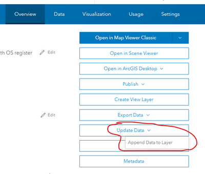

e_mcc
Have you tried to update the layer in AGOL?
go to the hosted feature layer, then select "update data", upload the 1000 new points, map the fields and then update.
Note: always take a backup from your map service/FS before updating it.
Cheers,
E.

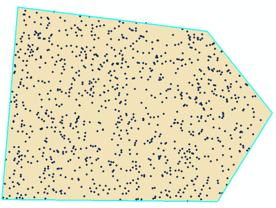

RobertBorchert
Honored Contributor
Are you trying to place the trees using Field Maps or ArcMap or ArcGIS Pro?
It would be easier if you use Pro or ArcMAP
Place 20 trees by hand copy and paste you now have 40 copy past you now have 80 copy paste you now have 160 etc etc.
Or in ArcMap or ArcGIS Pro there is a tool called Create Random Points.   The points can be constrained to a polygon that you have selected.
The below example is a polygon I drew, selected, and then ran the Create Random Points tool.  I selected 1000 as the number

e_mcc
Cheers,
E.
GroundworkORVGIS
Thank you for your reply. I forgot that I posted this question. What you suggested worked very well.
RobertBorchert
Honored Contributor
GroundworkORVGIS
I ended up using the Create random points tool after I drew a polygon in the area where the trees were planted while I had the AGOL field maps collection map open in ArcGIS Pro. Then the layer automatically updated in AGOL. Thanks! Sorry about responding so late. I forgot I asked this question.
