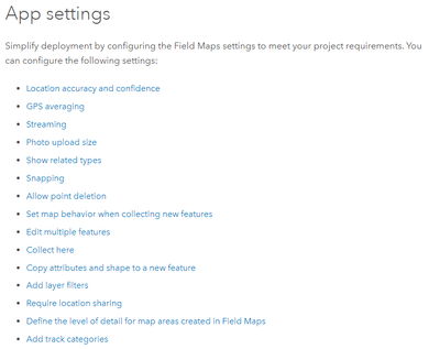

Hello, is it possible to configure the Field Maps settings shown below using the Python API? If so, is there any documentation available on how to do it?
Thanks

This is a great question and the answer to the question is yes, you can update the settings using the ArcGIS API for Python and by extension using the ArcGIS REST API.
As far as I can tell, this is not publicly documented anywhere; so you heard it here first.
Where are these settings stored?
The Field Maps app settings are not stored with the map's definition.  So you won't be able to get them or set them using AGO Assistant or the by accessing the web map objects definition using the ArcGIS Python API.
You may be surprised to learn, as was I, that Portal/AGO items can have resources.  These resources are files of various types (JSON, XML, TXT, PNG, JPEG, GIF, BMP, PDF, MP3, MP4, and ZIP).  As far as I'm am aware, you can not access these resource files in the UI, it is all run behind the scenes.
Resources is a property of an item.  You can add, export, get, list, remove, or update these resource files.
The settings in question are stored in a file named field-maps-settings.json.
