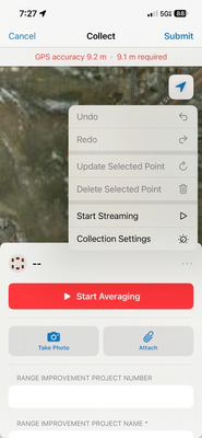

I think the capability already exists, at least last time I checked. In field maps you can specify the interval to drop vertices, if it is a line, or points at regular intervals. You would just need to set in in field maps as part of the collection settings.
I don't know which version of enterprise supports it but in AGO it is possible.
AlfredBaldenweck

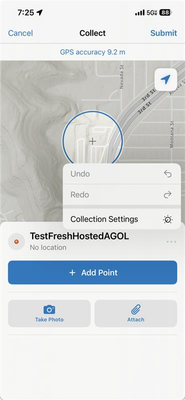

You can set the stream interval using the collection settings button, but for points there isn't any option to actually stream the way that there is for lines or polygons
