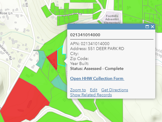

So, our field staff use parcels as the spatial representation of where to go and do household hazardous waste assessments, and they change the status on the parcel layer to signify if it's been assessed or not. This changes the symbology so they can still see on the map what has been cleared that day and what hasn't.
If we were just pulling through data from the related table, then your arcade expression would work great. Unfortunately, we have to also symbolize the parcel. Ideally, our user could use Field Maps to change the status on the parent parcel, and then also collect the collection data in the related table, but I think we're still missing a few pieces.
