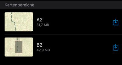

HannesVogel
I use a lot this basemap and I use offline map areas and with that I get pretty small download sizes:

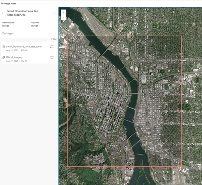

Creating your own lightweight basemap as @DavidSolari suggested is a good options, as is using a raster tiled base map (as suggested by @HannesVogel). One good option to use would be the Imagery basemap.  When you take it offline you can adjust the level of detail so it stays quite small.
Another option to try is to use a preplanned map area.  This way you can reduce the number of times you need to wait for the map area to generate.  You just need to make sure you remove the area off the device and redownload it.  If you are making schema changes to any of your layers you will need to recreate the offline area.
As an example an area covering downtown Portland Oregon is about 1.2MB
