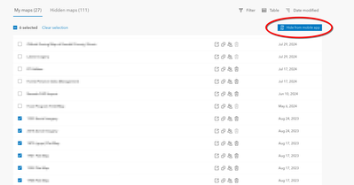

KenBuja
This is already available in the Field Maps Designer. See this documentation
The Field Maps mobile app provides access to maps that are shared with or owned by a mobile worker. You may have maps that you don't want accessed from the mobile app. For example, you may have maps that are made for ArcGIS Dashboards that are for desktop use only. To hide maps you own from the Field Maps mobile app, complete the following steps...

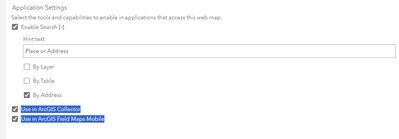

JustinReynolds
You can hide Webmaps in field maps by changing the 'Use in Arcgis Field Maps Mobile' option in the Webmap settings. Not sure about the Base maps.
jcarlson
In Field Maps Designer, you can do it as a bulk action, it's very convenient.
Kevin_MacLeod
Wonderful, that's perfect. Idea can be closed. I'm just getting back into development, many new things to spin up on. Field Maps Designer is a godsend. Thanks all!
