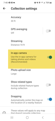

DougMorgenthaler
Status changed to: Implemented
With the 24.2 release on Android, we have added support for a new in-app camera as outlined in the documentation.
WardMitchell2
Hi @DestonHoward , Regarding the Samsung tablet I use there has been a fix to the camera issue. Under your profile in Field Maps. Select the "Collection Settings" and then turn on the ' In-App Camera" option. Hope this helps.
