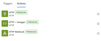

This isn't Esri or @Anonymous User's fault, but it should be noted that the HTTP action on which this whole workflow stands is not available to all users of Power Automate by default. HTTP is a premium action.
by Anonymous User
Not applicable
That's a good point @Anonymous User. I added a note to the blog post about that.

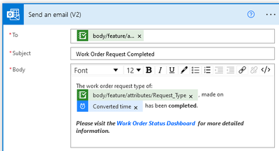

I am making my way through your blog on how to set this up. I am curious how I would update the "Parse Edits" step's JSON to include specific attributes from my feature layer. Ideally, I'd like to set up the email so that it dynamically includes attribute information. I guess I am thinking like what I am able to do if I set up a webhook for Survey123. Here is an example of what I am talking about:
I've done this for a different webhook where a survey triggers an update to another hosted feature layer. I have been comparing your JSON from the "Parse Edits" step with the JSON I use in that other webhook and just can't figure out where I'd insert something similar to call specific fields. In my other webhook, I use the following JSON to call specific attributes from the feature layer:

Last question. If I want to re-format the email using HTML, how do I format the attribute field names to call them into the email body? With Survey123 I use the syntax triggerBody()?['feature']?['attributes']?['field name'] - is it the same here, or is there documentation that can help me figure out what I should be using?
Thank you!
by Anonymous User
Not applicable
I think it will be:
@{item()?['attributes']['field name']}
Since item references a feature object. I don't have an example to test with at the moment though.
erica_poisson
I just tested and this worked perfectly.
