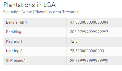

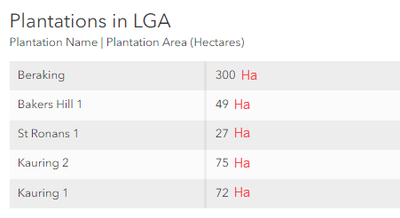

So I've been experimenting with your code. I've managed to get it to return a list of Plantations within an LGA, but I'm guessing it's returning them ordered by first feature found - any chance we could sort the results alphabetically?
I've also experimented with adding text to the end of the area value returned, but each location I've tried adding text to the end of the returned value (Lines 21, 32 or 43) has just resulted in the Summing or Value return not working properly. I'm currently stuck with the total number. (i.e. want to format the returned area as "100 Ha" to represent Hectares instead of just "100").

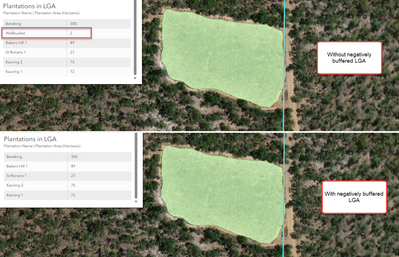

Hi @KerriRasmussen. My code is below. You'll see that I've swapped most references to land use to Plantation Name (the layer and list field are both called "Plantation" with my Area field being "AreaHa"). You'll see that I've swapped out the Area calculation for summing an area field within my attribute table (to provide consistent results with other reports).
I've also included a negative buffer at the beginning to prevent features that slightly overlap LGA boundaries being counted where they shouldn't be.

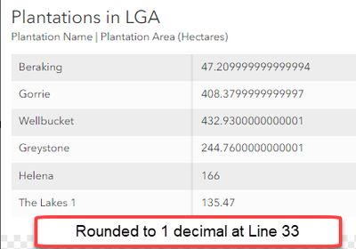

An additional comment on my above issues around the " Ha" suffix to the results is that where I have Rounded the figures to 0 decimals, I was trying to do it to 1 decimal, but found some results would still come out with 6(?) decimals. Also, that Rounding had to happen by feature (Line 22) instead of on the overall outcome (Line 33) as that also had unpredictable results with some lines being rounded and some not. Rounding to 0 decimals was the only way of getting consistent results for all records returned.
It would be good to pad with 0's as well if rounded to 1 decimal, but fear I'd run into a similar problem to the above " Ha" suffix and the summing of values by formatting the text result #.# but haven't tried it.

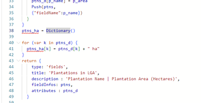

Second, when it comes to rounding, you will want to use the AreaGeodetic() function to find the area of the polygon, like you see in line 21 of the original expression. You can swap out "square-meter" for "hectarces", so that line would look like:
var p_area = Round(AreaGeodetic(LGA, "hectares"),0)
This is telling the AreaGeodetic() function what units to use while calculating the area for the polygon. Using the area field that is calculated automatically can cause issues when using arcade, it's better to use the AreaGeodetic() function when making calculations using areas.
And lastly, to add the "ha" label, you will want to add the following to the line about your results section (so line 38).
ptns_ha = Dictionary()
for (var k in ptns_d) {
  ptns_ha[k] = ptns_d[k] + " ha"
This will add the "ha" string to the end of your result. I hope this helps.

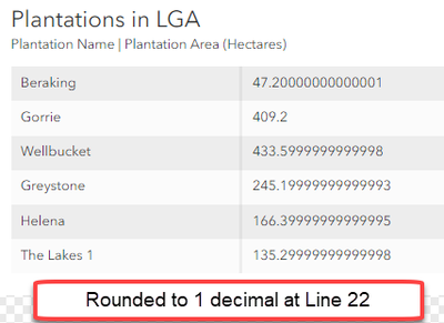

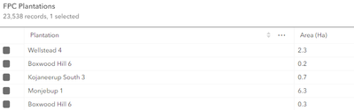

@KerriRasmussen Thank you for your response! I've implemented the sorting and that works perfectly. I'm struggling with the addition of the " Ha" suffix bit though (not sure where I'm putting it).
Regarding the rounding solution, I just wanted to clarify something on my original post. The AreaHa field I'm using is actually a static area figure (calculated in ArcGIS Pro using a different projection) and not an auto-calculated field (like Shape_Area). This was our preference so that the areas returned in the popup match what is calculated and reported on in our plantation database.
When I try your solution rounding to 1 decimal, it still gives the same results as per below, which is the same as if I use my static attributes (despite them only containing 1 decimal to start with - sample data at bottom).

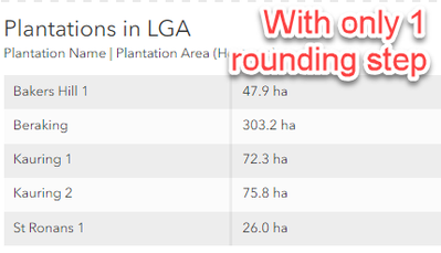

ChrisDunn1
Hi @LindsayRaabe_FPCWA ,
For the step where you add the "ha", you just need to use the new dictionary, ptns_ha, as the attribute parameter in your field list (line 48) instead of ptns_d. I also think you'll need a "var" before the ptns_ha on line 38 to declare it as a variable (our bad for forgetting that in the example).
I think you can actually add a step to round your results as part of that dictionary creation as well, so your new code should look like this:
var ptns_ha = Dictionary()
  var round_area = Text(ptns_d[k], '#.0')
  ptns_ha[k] = round_area + " ha"
That should round your area values and add the "ha" to the end.

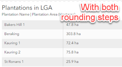

LindsayRaabe_FPCWA
MVP Regular Contributor
@ChrisDunn1 Perfect! My complete code below. I tested you're suggestion with the Rounding included at Line 22 in addition to your rounding step, and without the rounding at Line 22 (and just using yours). It looks like it works best with just yours in place (returns different results - I suspect double rounding skewing the results with both steps).

Incorrect sums:
Correct sums:
Thanks again both @KerriRasmussen and @ChrisDunn1 for your help. This stuff is really useful and I can see it being used more and more in our ArcGIS Online space!
