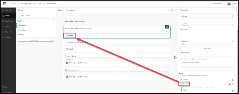

When configuring the form for the edit-enabled layer, set a field to be *Required:
Then, for the same field, click on the settings cog next to the 'Editable' logic to configure an Arcade expression:

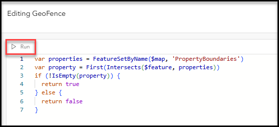

Name your expression something like 'Editable Geofence', then click on 'Launch Arcade editor', and use the following Arcade example as a guide:
var properties = FeatureSetByName($map, 'PropertyBoundaries')
var property = First(Intersects($feature, properties))
if (!IsEmpty(property)) {
  return true
} else {
  return false
This code block will be applied at the time of digitising a new point feature or performing an update to the geometry of an existing point feature in this layer.  In the Arcade sample above, we use:
  • the FeatureSetByName function to call the polygon layer in the web map and asign it to a variable (var) named 'properties'
  • We then use the First and Intersects functions to find the first feature in the polygon layer that our point intersects with and assign it to a variable (var) named 'property'
  • We then use an if statement to check if the 'property' variable is not empty (!IsEmpty), returning boolean values:
    • true - the field will be editable if the 'property' variable is not empty
    • false - the field will NOT be editable if the 'property' variable is empty
Click on 'Run' to test your Arcade script and check if it spits out a 'true' or false' sample value. Then save your form in the ArcGIS Field Maps Designer.

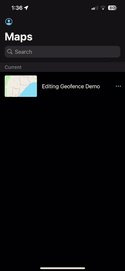

The next step is to test the behaviour in the ArcGIS Field Maps mobile app.  In the GIF below, we drop a point outside the boundary polygon features and the form logic prevents our required fields from being edited, which prevents the point feature from being submitted.  Once we correct the point location to intersect a boundary feature, the required fields become editable and the new point can be submitted successfully:
