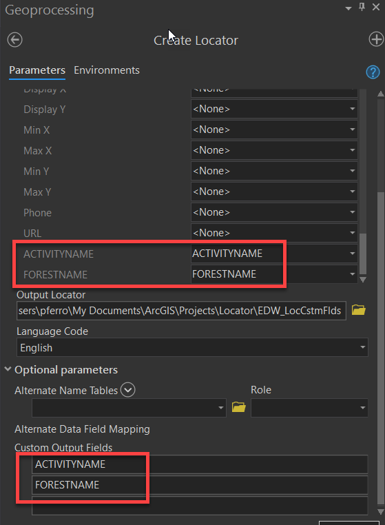

I used the create locator geoprocessing tool with the POI role from a feature class. I then add custom fields which do show up in Pro results (2nd screenshot) when you use the Locate tool.

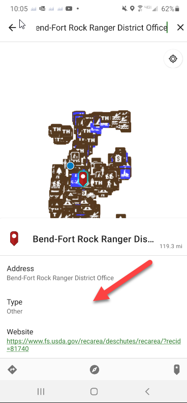

However, these custom fields do not show up in ArcGIS Explorer or in Field Maps Beta:
No ACTIVITIYNAME or FORESTNAME. I have made sure these output fields were checked in the Locator properties before creating and sharing the mmpk.
